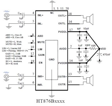

典型应用图
http://www.szczkjgs.com/uploadfile/20190214/20190214125404633.jpg
http://www.szczkjgs.com/uploadfile/20190214/20190214125416932.jpg

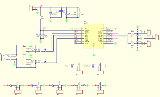

DEMO板电路图

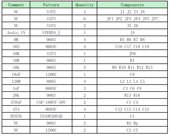

DEMO板物料清单

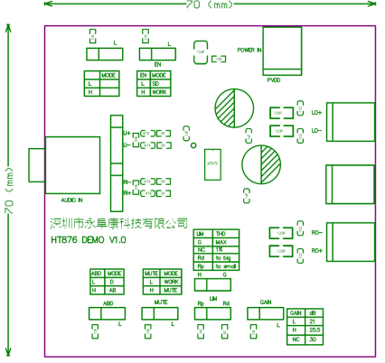

DEMO板PCB顶层贴片图

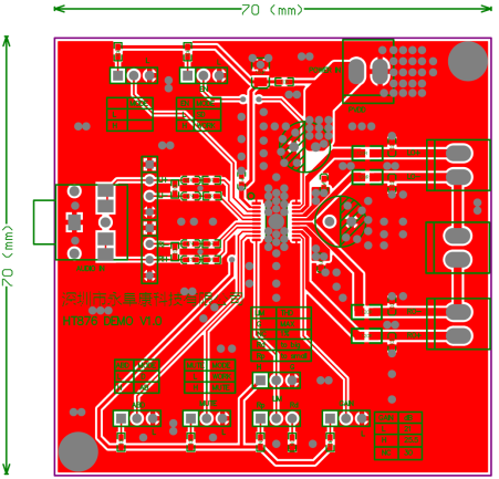

DEMO板PCB顶层设计图

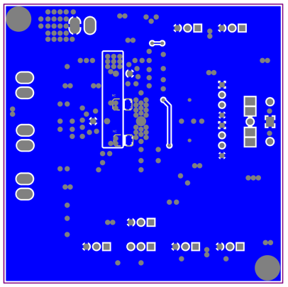

DEMO板PCB底层设计图
