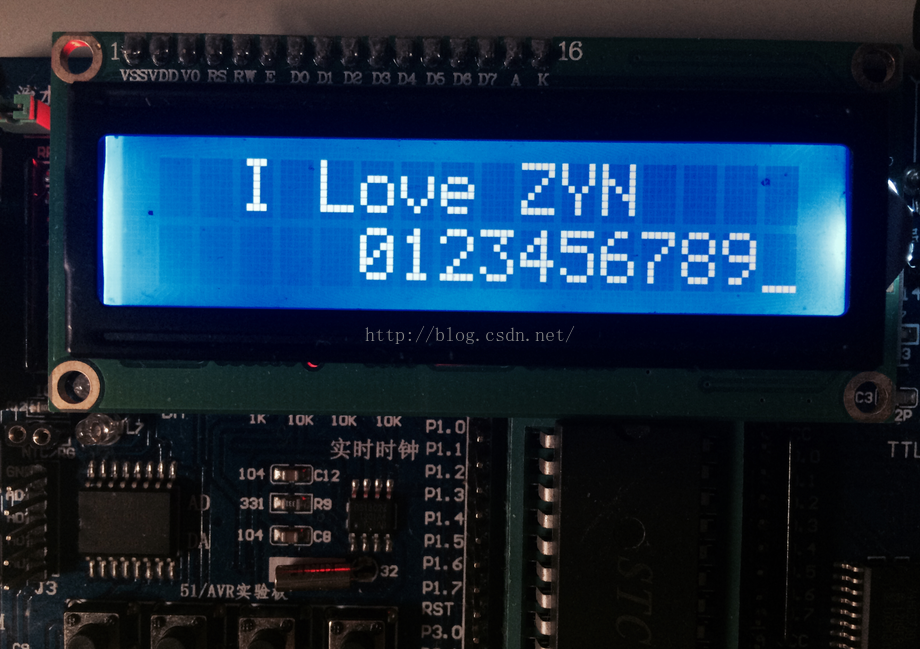

基本框架根据郭天祥Lesson8中的程序来编写,但是渐入显示的时候郭用的指令是write_com(0x18);
可我用的时候就是显示不出来,于是根据1602的说明书,用了另外一个指令write_com(0x07)    //当写一个字符,整屏显示左移
程序如下:
可直接运行,已调试OK
#include
sbit LCD_rs=P1^0;
sbit LCD_rw=P1^1;
sbit LCD_en=P2^5;
unsigned char num;
unsigned char code table[]="I Love ZYN";
unsigned char code table1[]="0123456789";
void Delay(unsigned int i)   //注意,若此处用char声明,否则会看不到延时渐进的效果,疑问?
unsigned int j,k;
for(j=i;j>0;j--)
for(k=110;k>0;k--);
void LCD_Write_com(unsigned char a)
LCD_rs=0;
Delay(5);
LCD_rw=0;
Delay(5);
P0=a;
Delay(5);
LCD_en=1;
Delay(5);
LCD_en=0;
Delay(5);
void LCD_Write_data(unsigned char b)
LCD_rs=1;
Delay(5);
LCD_rw=0;
Delay(5);
P0=b;
LCD_en=1;
Delay(5);
LCD_en=0;
Delay(5);
void LCD_init()
Delay(15);
LCD_Write_com(0x38);
Delay(5);
LCD_Write_com(0x08);
Delay(5);
LCD_Write_com(0x01);
Delay(5);
LCD_Write_com(0x07);  //当写一个字符,整屏显示左移
Delay(5);
LCD_Write_com(0x0e);
Delay(5);
void main()
LCD_init();
        LCD_Write_com(0x80+0x16);//此处0x16也可用十进制数22
Delay(5);
for(num=0;num<10;num++)
LCD_Write_data(table[num]);
Delay(3000);
LCD_Write_com(0x80+0x59);//此处0x59也可用十进制数89表示
LCD_Write_data(table1[num]);
Delay(3000);
while(1);
实际效果如下:
